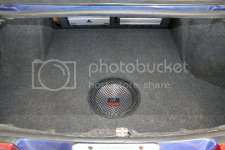

i use a Kenwood KVT 512. i love it. and it can be had for about 360 bucks.
for straight cd/mpe play? id suggest a pioneer with ipod connection
toss the cap in the garbage.
get some fiberbord and build yourself an amp rack.
IMG 6119

I will get some fiberboard and carpet, then i'll figure out how to secure it.

Thank you and nice setup
