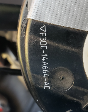

I always had to get a used clockspring that matched the part number on the original unit. THere are several different ones manufactured in different places. Once I had an auto electrical specialist repair one to finally get it fixed. Solder and a huge magnifying glass. This dude was old school.

While you are in there take a pick of the clockspring part number and it should indicate a city of mfg. I think you have to match both. My used ones were hit and miss. Got one repaired by a pro that worked great. Save your old one in case you have to track someone like that down.

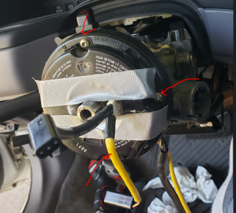

9) Now you can see the clock spring. You will notice that the wires were broken off the clock spring.

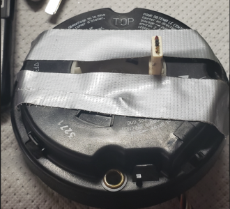

14) Place tape over the clock spring to prevent movement.

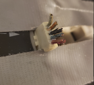

For my particular case I needed to repair the wiring to my clock spring. The wires from the clock spring to the airbag and steering wheel controls were complete disconnected.
1714772815479
Look at those short little nubs. I used a Dremel to shave down the plastic to have enough wire to reattach the wires.
1714772885978
A few minutes with a soldering iron and some heat shrink I was able to successfully reattach the wires.

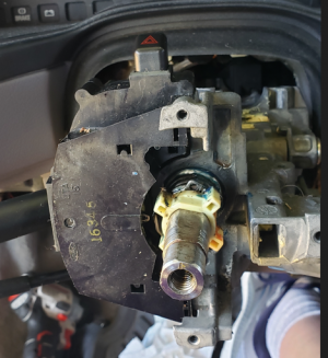

17) Remove the turn signal switch assembly. I think I remember two screws and set aside. I was able to leave the assembly connected to the wiring.
18) Remove the whitish piece that is the turn signal cancel cam. This part just pulls off the steering shaft.
1714773148597
19) That exposes a snap ring that is a bugger to remove unless you have a large pair of external snap ring pliers. I purchased a set from Harbor Freight(https://www.harborfreight.com/12-in-external-straight-precision-snap-ring-pliers-57800.html)

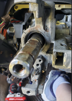

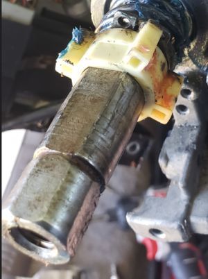

20) Remove the spring and now you have access to the upper bearing.

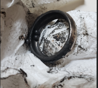

My upper bearing was so damaged that I was able to use a screwdriver an pry out of the column.
1714773332129
21) clean the steering shaft to ready the new bearing.

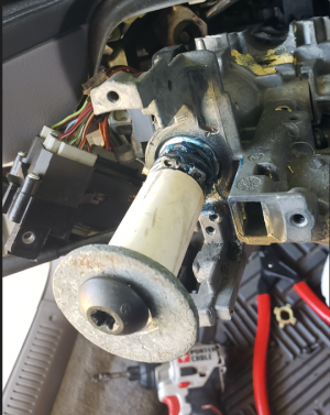

22) Install the new bearing using a small punch and a hammer. Just go around easily as to not damage the bearing. The bearing went in fairly easy.
23) Add grease to the front of the bearing and both sides of the spring.
24) use a piece of 3/4" pvc pipe that is 2 /12" long to press on the new snapring back into position. I used the center bolt and a few washers to compress the sping and set into place the snap ring.

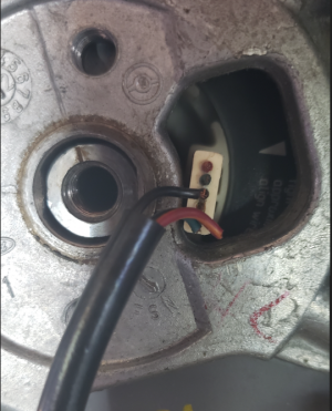

30) Align the steering wheel back on the shaft while guiding the wires through the cutout in the steering wheel.
My steering wheel had an alignment mark that aligns with the steering wheel.
1714774087712

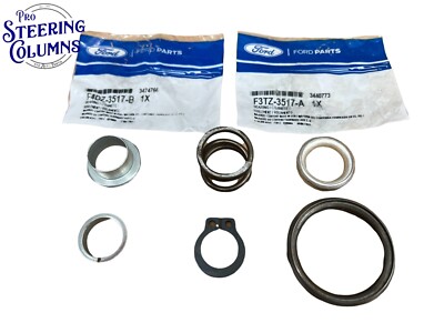

I should have included the parts:
This kit includes upper and lower bearing, spring, clip and spring mount.
I also found a used clock spring from Pro Steering Columns.
I know it says crown Vic, but that is the correct part number from my vehicle.
