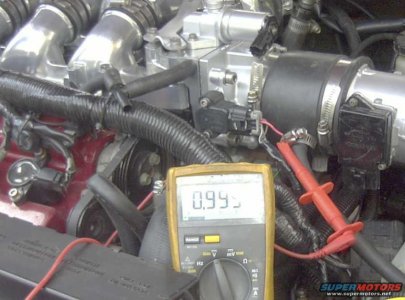

To check the TPS you can stick some small wire in the back of the connector and measure the voltage. It needs to be on the car.
One wire is the 5V in , another is ground and the other is the signal return which is what you want to measure. It should be ~.90v to .98v with the key on and throttle shut. ~4.85v at WOT. As you slowly open the throttle all the way the voltage should rise steadily with no sticking points or sudden changes.

I use 20 ga solid wire like found on fluorescent light ballast. You just poke it in the back......
Like this
Tps after adjust
