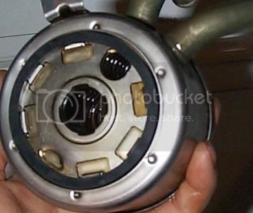

If it's acutally the oil cooler...it's between the block and the oil filter. Those leak like seives too. You can take it off of the block with a 30MM socket(same as your front hub nuts) and replace this:
Oilgasketsside
Thats the old gasket on the left and on the right is a standard oil filter gasket. I just removed it from the filter...tossed the filter in the trash and installed it on my oil cooler....like this...

Or you can buy the proper O-ring for the oil cooler behind the oil filter from Ford.
My powersteering cooler was all nasty along with my lines. I replaced the lines and bought a new cooler - good to go now. The cooler is still readily available from Ford and not very expensive. And looks great to boot!
