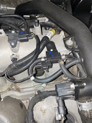

Take the engine cover off, a little behind the front furthest right spark plug is a little black box that will have 3 different small vacuum lines coming off it. One of those goes directly to the right and hooks onto the charge pipe. It is extremely common for those to get blown off because ford thought they did not need a clamp. Having that blow off will cause you to have no boost.
If you can't figure it out just post a picture of your engine bay in that area on here and someone can tell if that hose has blown off.

ImageLooks like all the lines are attached but the far left one has a piece of some sort of tape wrapped around it that was peeling off. i took it off fully and couldn’t see any holes on the top side at least. Think there could be a small leak around there?

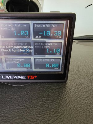

If you have a tuner like sct. You can read it through the obd2

if you have a tuner (or plan to tune it) and a laptop you can download livelink and I can send you a config file to save you time. then you can run a log on it to see if your hitting commanded boost.
