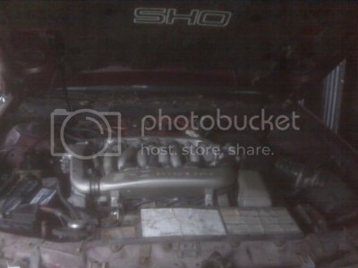

The garage is tiny with no electricity so I have been waiting for the weather to turn into its current state to attend to this car. I have been doing small odds and ends...anything I am capable of with my knowledge and lack of adequate space. The fuel had already been drained which I was pleased with. I replaced the filter and what little was left in the lines came out clean and still had a strong gasoline smell to it. I wanted to change the oil but the drain plug was rusted to **** and/or stripped previously. Replaced the battery. Attempted multiple times to remove the drain plug from the oil pan with no luck. I was too anxious and needed to see what I was working with so I unplugged the DIS. Cranked the car out in a few intervals to get the oil circulated a little. Plugged the DIS in and shot up a prayer. Started right up....runs extremely smooth and quietly as it still is holding onto its original exhaust (probably not for too much longer, however)

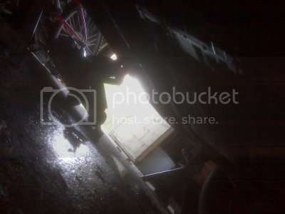

Besides needing to replace the brake lines, probably the brakes as well and seeing what the issues are with the trans; the car seems to be in good shape. One thing is for sure, I dont like the look of is this...
Seems to be coming directly from the trans.

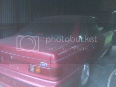

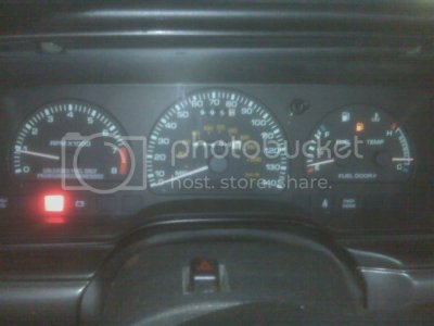

A few more pics (sorry about the poor quality. The car is also a total mess...has potential though.
Looks a lot cleaner in person

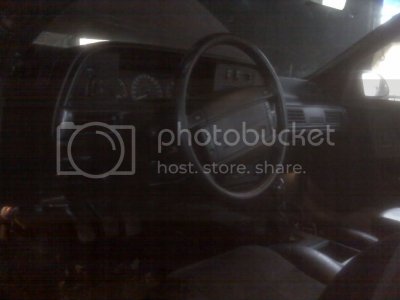

Clean 50/50 interior. I have full leather in my current plus that will likely end up in this.
