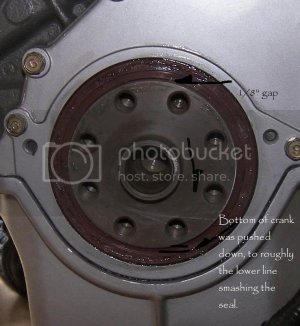

Ok, I have done all the maintenance on this car in the past, with the exception of my clutch. When I pulled the flywheel and clutch assembly off, looking at my rear main seal, the crank, or actually the 'thing' the flywheel bolts up to, was resting on the rear main seal. Like there was almost 1/8" gap at the top of it!?! I know that shit can't be normal. There is even some scarring on that part, wore a little ridge into it. Wish I had a better camera to show you a picture, but anyway. My main caps were loosened when I origionally opened the bottom end up looking to change out my rod bearings. Could the mains being loose make it set that much lower and rest on the rear main seal? Before I took the plate off, I tightened the #4 cap, and nothing, didnt pick it up at all.. so I dont know, is this something they messed up? Is that why my car was ticking for a 1000 miles before I spun that bearing?
**** there are peices of shop towel in the space where the clutch was.. ?!?!? are they that lazy? I don't know, it just looked real sloppy, and if the crank was 'off' at one end, that would make sence why my rod bearing spun? I noticed the tick right after I got it back, but they told me it was just the new TOB.. mind you I had the metal sleeved one, not a ceramic.

They flywheel bolts to the crank. Post a picture.

yea i know , that part that it bolts to... the big round end, with 8 holes.. that was resting on the bottom side of the rear main seal.
I dont have a digital camera, I been taking 35mm pics, and having them converted to CD's.. lol sorry i can't get one faster.

im not a expert here but i think its just the rear seal being off some i doubt the crank part where the flywheel bolts is off since the cranks are very heavy duty

Wait, Eric, are you saying that when you went in the motor, the main caps weren't tight at all? Not the rod caps, but the main caps; the big ones.

I loosened the mains after i found the rod bearings to be out of spec. But, after that the motor never turned over and the wear that was on that end of the crank had to have happened when it was still spinning, being that it wore the groove into that part of the crank . the back of the flywheel was dry so nothing got past it but it looks like it wasnt right for awhile before i ever took the bottom end apart. i wonder if maybe they installed something wrong when they put my car back together when they did the clutch. i dont know how they did it whether they dropped the sub-frame or not, but i remember having them replace the rear main seal when i had it fixed . so i know they had their hands on it. i wonder if they did something wrong and that is what lead to the premature failure of the rod bearings.

If the rear main seal was mis-aligned that much there would be oil all over about 5 seconds after the engine started. There normally is a wear groove on the rear of the crank. When a new rear seal is installed it must be greased to prevent the crank from ripping it up real fast.

Yea, I noticed on the new one I have, it has grease in the center part, but It just suprised me to see the groove wore into it. And I did think it was quite strange being it was dry behind the flywheel. I remember a long time ago someone having a problem with a slipping clutch, and it was due to a leaky rear main seal. I just dont know what kind of pressure is behind some of these things. :) I sure am glad to be finishing up putting this beast back together tho!!!

Pressurized oil is only on the bearing surfaces of the crank. The rear seal only contains the oil that is splashing around in the crankcase, it holds no pressure. Was there a lot of oil running down the oil pan in the rear? That's where most of it will go, then the wind will blow it back to the floor and exhaust pipe.

Well, there was quite a bit, nothing crazy tho. There was a lot built up just above the seal tho, more of a dirt / oil mix. It was pretty thick, around the outside edge. Taking a lot of cleaning to get mine to look like his up there.. :)

There is no way there should be an 1/8 inch gap at the top of the rear crank seal. I would pul the oil pan and check the bolts for the crank bearing caps. something is not right. The carrier for the seal is mounted on guide pins and it will center the seal over the crank so the seal mounting should not be the problem. The other possibility is that the crank is bent. While this is unlikely, you can rotate the crank by hand (clockwise with a wratchet and socket on the front of the crank) and see if the "gap" rotates around the seal. Again, something is not right and needs attention.
Note that the seal has a spring around the inside of the rubber that holds the seal to the crank. The spring may be broken or displaced. This is a common problem when these seals are replaced without using the proper tools, or at least a proper tecnique. Beating them into place often dislodges the spring. Hi Perry.:wave:
