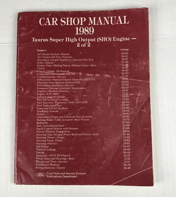

Be a pro with codes, get a used engine manual (Helm's/Ford Shop manual) that you can find used cheap on ebay. This is the seperate 1989 shop manual for SHO specific engine and transmission. This is about all you need for a manual transmission car from 89-95. There are other one's on ebay but you need to verify they have all the info you need

Yeah I posted that like a week or two ago. I am older so I prefer the physical book right where I am working. For the price you can't go wrong.
