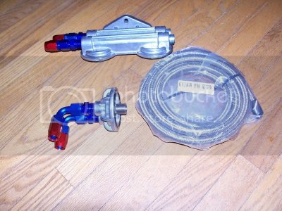

Because of the headers ( and other stuff) I decided to move the oil filter off the engine. I didnt want to use the factory cooler and may put one in line after some oil temp studies
The hardest part was to find a short 20mm-1.5 to 3/4-16 conversion ****** ( dont google 20mm *******, it doesnt take you to car parts)
I did find a comapny that made one and it only set me back $8.00, The rest of the stuff is standard AN fittings and stuff

I bought extras in case anyone needs some......

Its made by Mocal part number.... tn3/4m20 I found one on ebay ( its gone now) but anyone who sells Mocal parts can get you one
These people can order it for you $8.99..... It not liseted on their page , special order takes about a week.
I have a lathe and for this price it wasnt worth setting it up.
