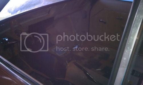

Interior is stripped sans headliner. Door panels will just go with the doors when they get pulled off. Thats what I did this saturday and a little bit sunday. Did some F1 go karting at NJMP, so that took away from working on it. A good trade off IMO :)
A pic of it gutted

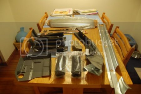

The RUST
Here the major parts of the car affected by rot. I really do hate rust. But for the most the car is overall pretty solid, considering these car usually rust to peices, as no one cares bout them. The rust will be getting fixed (got all the parts,pic on pg 2) but first is going to be the cutting and welding to make the engine/bell housing fit. Which it will except in the height department....pretty sure of that. But a bulged hood should fix that if needed.

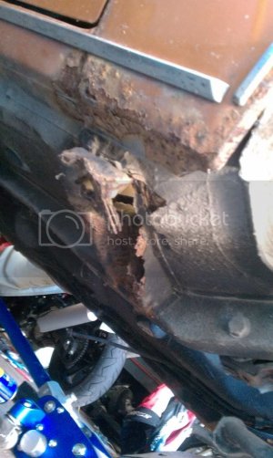

Driver side unibody under batt tray. Pretty common... caused the battery always ending up leaking and running down. also the jack point is affected

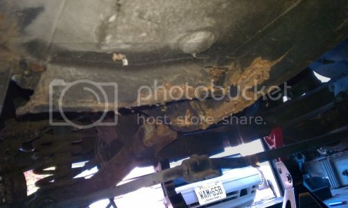

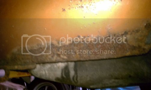

Pass-side jack point...GONE
IMAG0149

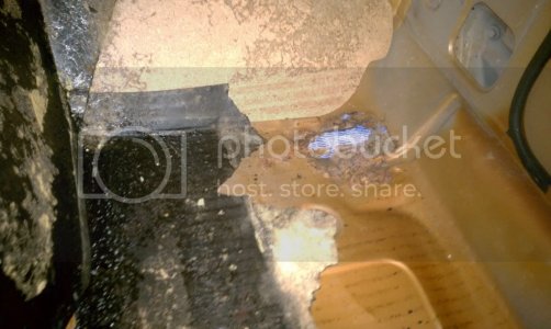

The hole in floor above jack point
IMAG0144

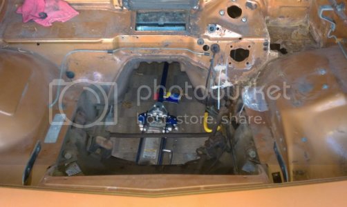

And an overall of the engine bay. Empty just need to buy a star drive to get the stubborn motor mounts out! steering shaft is staying cause thats not being modified
