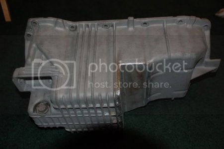

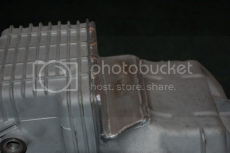

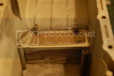

Picked the up oil pan today. Ill let the pics explain themselves. I also sandblasted the whole oil pan too before the welding.
DSC 0056
Upclose

Inside... u can where the pickup screen goes so it definalty clears.

wow thats awesome! good job with this build. i cant wait to see this done and tearing up the pavement.

damn that looks pretty good. only thing is id be cutting as much as i can out of that engine bay before i started modding the motor to fit. that thing has lots of potential for a bigger bay.
whoever welded your pan has skills. just get them to cut and weld inside the bay?

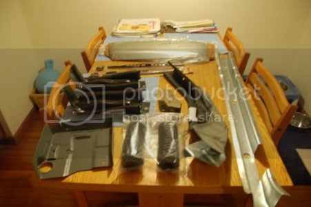

so uhhh.
whats all this?
Yea james is right. Damn rust. Engine had to come out anywho for this so if the SHO thing dont work out it not a big deal.
From left to right.
Two jack points, battery tray at the bottom, back is the bottom of both Q-panels. and on the right is left frame rail, and upper left frame rail w/reiforcement. and some new boots for the steering rack. overall I got damn lucky with the car. These things are known to litterly rust to peices
