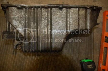

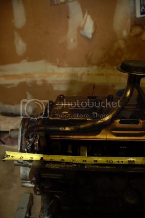

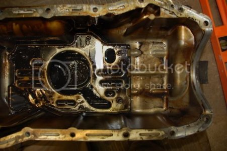

Well tonight I did a little brainstorming for the oil pan problem. I looked at how far I can go forward and how shallow I can make it. Here are some pics to explain myself.
Heres what I want to do. Just extend the shallow part more. it will only be about 3 1/4 inches but that may just do it. Thats as far as I can go b/c of the oil sump, right now the line is about 1/2" away from it. Some pics to visualize my idea. Only negative I see is gong to loose the dipstick and some oil volume.
Pics of my idea

Going to have to cut the baffle inside. clean spot is 10"s

Oil pick up is about 10.5 inches from the edge of the oil pan.

Oil volume can be picked back up by running a remote oil filter and an FL1A filter. From the looks of things, you'd only be losing about 1/2 quart anyway, which would be made up for with just the filter.
Not sure why you'd lose the dipstick, though.....worse comes to worse, just chop it at the top and make it happen
