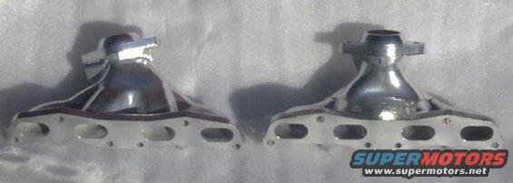

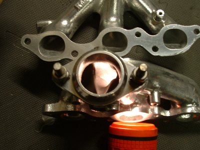

SHOZ123 said:
Jet Hot is great!
Ex manifolds 2
I have the same thing, but with 6 holes. :thumb:
If your going to have it done, dress out the manifolds with a Dremel. Casting slag and such. It makes it look really prrrretty.
