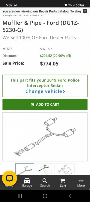

Just out of curiosity I was going through the online parts catalogue from Ford. I decided to check out the stock SHO and police interceptor exhaust systems. For some reason the police interceptor cat back exhaust is cheaper. Do the EcoBoost interceptors not have the third cat? Can't tell from the picture it's just a representative illustration.
Could the crome tips be $200 a piece?Screenshot 20211025 173815 ChromeScreenshot 20211025 173720 Chrome

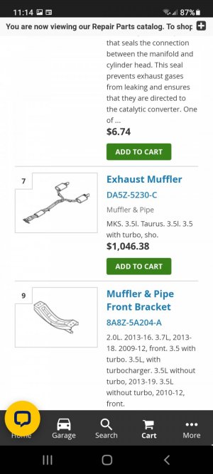

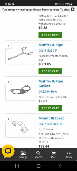

Yes, I made sure I checked on the 3.5 EcoBoost version. Mind you the N/A P.I. 3.7 litre engine version of the exhaust is a true dual without cat or resonator and it's about another hundred bucks cheaper.
Weird, the four cylinder ecoboost exhaust is actually about 20 bucks more expensive than the dual exhaust when not on sale
Screenshot 20211025 172944 ChromeScreenshot 20211027 111143 ChromeScreenshot 20211027 111451 ChromeScreenshot 20211027 111858 ChromeScreenshot 20211027 112137 Chrome

Comparing the FPIS 3.5L EcoBoost and the SHO, The only part that is different is the muffler, pipe, resonator assembly. All of the front cats, intermediate pipes, hangers, gaskets, etc. are the same. That would lead me to believe that they are the same part minus the tips. Gaskets matching in size makes me think that both are the same diameter. The SHO exhaust even lists the 2013 FPIS under the fitment. I would say using the FPIS exhaust should work and you could just put tips on it if you want them.
