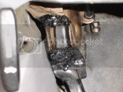

I have had a little problem with my parking brake light. It would flicker when I hit bumps and I could sometimes get it to go out if I tapped it with my foot.

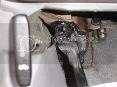

I thought the little pad (that contacts the switch) had somehow worn out. But when I finally got around to taking a look under there, I found the problem to be a little worse than a loose pad. It was a melted pad.
DSC01152
DSC01153
The little rubber pad had actully left part of itself on the bracket where the switch mounts. Some of the pad was still "solid," (but very soft) while some of it was more like the consistency of honey. It was SUPER sticky, and if not for a bottle of GooGone spray gel, my hand might still be stuck to the car.
I ended up fixing it for about $ .50 plus the cost of the 5-minute epoxy.

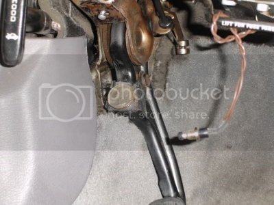

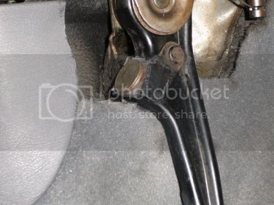

Here's my fix.

Yup same thing occured to me, the goop even got so melted as to drip on the carpet. That doesn't come off easily. (which is to say, there's still a mark) :banghd:
I scraped that off and just left the bare pedal as is. Works fine.

Wow! I thought I REALLY screwed something up, to melt that pad. That's weird! And I can't believe how sticky that stuff is. Goo Gone (panters spray gel) got some of it off, but it's on the carpet, my camera, my tools and my shoe. What a PITA!

HA! Sorry I forgot to mention it earlier, but the epoxy didn't hold. After the 3rd time I released the brake, the quarters shot out and landed on the left of the drivers seat. So I'm thinking that I need Sacagawea dollars and a lot more epoxy.
Well, maybe not. Now that I have cleaned the area, including the spring on the switch, it works fine, even without the little rubber pad. The spring was loaded with melted rubber, so that's why it was sticking so badly.

The rubber didn't melt, it decomposed. I have seen other rubber items turn to gooey mush too. Certain types of foam rubber seem to exhibit that trait. Could it possibly be chemical contamination??? Like maybe the vapors from your left foot? :laugh_ti:

To anyone who has this problem, (the brake thing, not stinky feet) and is about to clean it, just make sure you wear rubber gloves, have some Goo Gone ready and DON'T GET THAT STUFF ON ANYTHING!
