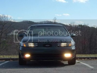

Okay, so for some reason, I love light mods...
I was going for something different, so honestly, what do yall think?

Its fairly simple, the hard part comes in getting the headlight open. I baked it at 300 F, and then pried and pulled on the lens, and it gradually popped off.
Otherwise, i just inserted a fog light sorta housing in there for the DtRL. As for the angled parking lights, I used sheet metal cut to fit, and then fastened them in.

I was talking to another member on AIM, and I wanted to make sure noone else made the same mistake he did. The lights are not blocked off. The rest of the area around the DRLs light up with the stock headlight. High and low beam work. The DRLs are wired in with the parking light, with its own circut like a fog light. The orange slices are only the low parking lights... the HI for the turn signal lights up the area to the inside of the angled orange.
I should have gotten pictures of that.

Hey what fog lights are those and how did you mount them? I am looking to add some driving lights to my 95 so I can actually see at night...
James Downing
Aug 24, 2003
586
Virginia Tech, VA
my fogs are hella ff55 if i recall correctly...
they are mounted directly into the bumper cover, for stabalization, i crammed foam between it and the stock fog housing...
i think thats your question...
