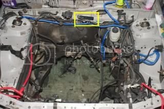

Ru3bbl
If all else fails, jumper the connector and see if it works, the highlighted part is the fuel pump resistor found on the Gen I's.
7,521
wasn't it only 89 that had that resistor?
