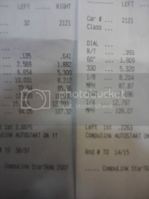

New best time and MPH

Only real benefit is that you can get a steady 2-3 lbs extra boost. Over that, it gets peaky...though does help some at high RPM. Negative that I have currently is too much spinning of fronts all the way thru first, and consequently having the thing shut down for a split second. That's why I have Nitto 05R's on order. Also, it makes the FRP drop more than before. That's why those Lambda Numbers are so critical to watch.
