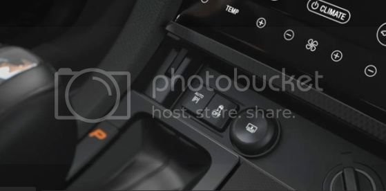

Can someone with a 2013 or 14 SHO PP post a pic of where their ESC off button is just to make sure he's looking in the right place?
Is this blank out next to the park assist supposed to be where the ESC off button is?
EDIT:
I have confirmed, yes the ESC Off button should be there like this:
ESCoff zps0133b151
So it sounds like you have a misbuilt car where they forgot to put in the ESC off button. You'll have to go to the dealer and they will order the button and replace it under warranty.
