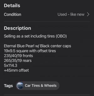

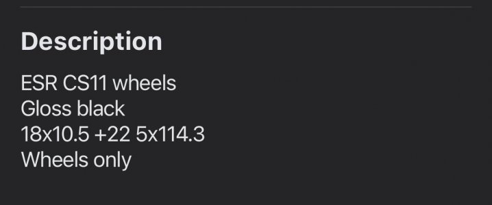

Can someone give me a quick yay or nay on if these will fit a 2018

18x10.5 +22 offset will technically fit bit depending on what you run for tires and if you’ve got lowered suspension the rear plastic fender liner/rear bumper tie in dips down into the radius of the wheel well so you might rub on the plastic there over bumps. I think it might be ok.
The 19’s +45 offset will be too close to the struts.

Thank you. I guess I’ll keep looking.
