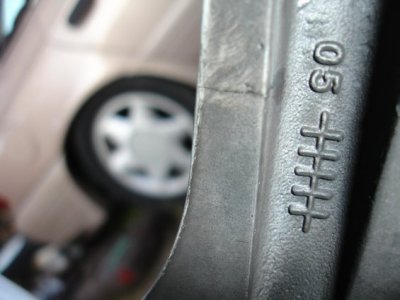

The 19s you see in my sig are RSLs, made by the same company that owns ADR. (Golden Apple) My 19x7.5s are 22 lbs. I did however put cracks partially through one spoke on each front wheel due to potholes.
Dsc19842r
*edit.. also, I'd upgrade to the 245/40s they list for $40 more. Change the load rating from 92 to 97.
