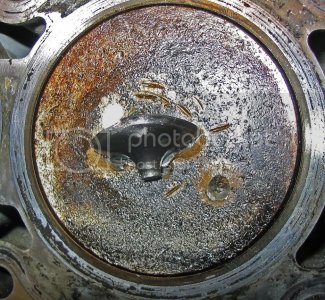

I've seen the valve stems get so carboned up they stick and pop the head off the valve leaving it embedded in the piston.
