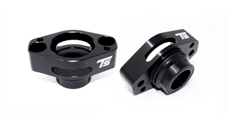

I have a 2015 ford Taurus sho and just wanting to see if this is the correct part or if y’all recommend something else thanks
It appears to be on paper, can’t say how it works in practice. The $3 rubber bottoms for chairs i bought from home depot are holding up great though after about a year in florida and 20k miles

Looks like a fancy way to do it. You will need 2. Also, you will either need to cut your re-circulation hose or get some hose. Most people go with the rubber chair bottoms or similar because it is a female cap for a male port. It appears the item you are looking at is a male cap for a male port. You need some way to mate them.

Chair bottoms for 5 years and 52k miles in Arizona for the win.
