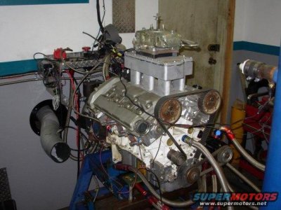

the OP is limited to basically the stock displacement.
the engine referenced in the article states pretty clearly that it's been bored and had the stroke changed and has custom one-off everything.
The rules are just for displacement, I don't believe it neccessarily has to be stock displacement, just under 3.014L
If the math is correct, and you punch out the bore and shorten the stroke, you would still have a sub 3.014L engine.

Plus if the shop that built the carb'd 500hp n/a engine is contacted, they'll probably still be able to make the rods/pistons for that build......or contact the owner of it to find out details. In my interactions with the few LSR guys I've been around, they'll help each other out with things.

My local machine shop guy (Joe) runs a yellow car at the Bonneville salt flats, Tracer Racer. He ran 250+ mph all motor. Its a 3.0L and made 490+ HP at the crank. I think he lost the record, and now wants to use the SHO V8, shorten the stroke to 3L. He also said something about using Kawasaki pistons.
If you want to get ahold of him, PM me and I will get you a phone number.
