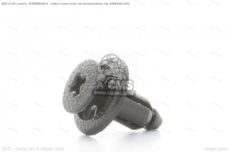

these clips right?
Body clip big90683MBW003 01 8d6c
Turn the inner screw counter clockwise until its part way out
now pull kinda ******* the screw/clip.
you can also use an eyeglass repair kit flat head screwdriver from the dollar store to pry it out
if the clip breaks you can always buy new ones for less than a buck a piece
