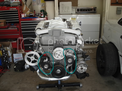

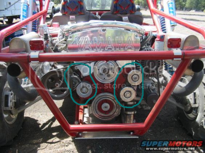

Does your engine have two accessory belts? If one, 3.2. If two, 3.0.
Also look at the pullies for the accessory belt(s). Here are pictures of both engines with the pullies to look for circled. See the difference?
3.0 (photo by nik97)
Identification 30
3.2 (photo by Off Road SHO)
Identification 32
I mean, sure people could have swapped accessories. I guess the only way to TRULY know is to give us some casting or ID numbers.
