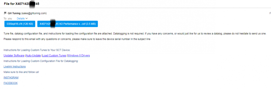

So I purchased a SCT X4 and tune from Gearhead. Received the tuner, sent the form, and received the tune email in record time.
1) I loaded the Device Updater without issue (windows 7/10)

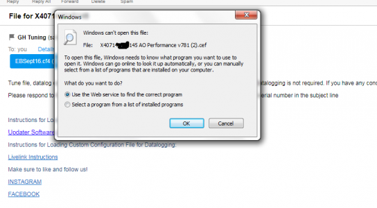

2) I went to the email and don't have a clue what to do. When I click on either of the two attachments my laptop doesn't know how to open them. I get the Download, but when I click to open my laptop doesn't know what program to use to open them. Clue me in if you can, I wanted to play this weekend and it's after hours for Gearhead by now so it's either figure it out or call on Monday.

Use SCT device updater to load the email’d tune to the device. This is without looking at it but open the updater and go to load custom tune and you just select it from wherever you have it saved on the computer.

I'm guessing that I need to save the attachments to my desktop, or will it grab them since I downloaded them?
Also, which one is the actual tune file (I just did the AO)

I clicked Automatically Check for Updates" and it shows that it's transferring *** of 986 updates. After playing with it, I'm guessing that was a SCT update.
I just clicked "Load Custom Tune File" tab and it gave me a AO Performance choice so I added that to the device. I didn't see anything pop up for the EBSept16.cf4 attachment in the email, so I'm guessing it runs in the background at this point.

That would be Gearheads configuration file. To load that you have to go to livelink. That puts the specific PID’s into your device that Matt wants to see in a log.

You’ll have to forgive me, I’m not in a position to look on a computer to know exactly what to tell you and also not the most well versed in livelink but just trying my best from memory to help you through.
In livelink you’d open that config file then I believe save to device. After that when you are in your car you can find that Gearhead configuration to run.
