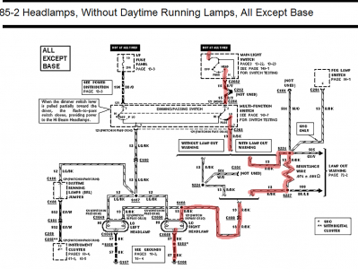

The 1995 has a much simpler diagram, where I've highlighted the circuit path if you've manually switched the lights on as indicated in the first post.
Light switch. Multi-function switch (hi/lo switch). The big square connector in front of the driver strut tower. Then all the ground wires bolted along the front radiator support.
