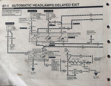

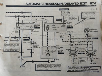

My guess is the light sensor. My 90 has the same problem. Would be interesting to find out whether the lights going off and on can be attributed to the amount of daylight present. Diagrams for a '94. '95 should be the same.
Automatic Headlamps Delayed Exit 1 1024x794Automatic Headlamps Delayed Exit 2 1024x771

New symptom I turned off my radio and rolled up the windows and drove slow with lights on I hear a click when they turn off and on like a relay of some sort is clicking could that be a sign of headlights switch?

If you look at the diagrams I just posted, you will realize it has to be the Autolamp Dual Coil Relay, not the main light switch. Not sure where that is. It might be in the Autolamp panel. Lower left on the dash with a thumb wheel. The panel can be levered out from the dash.
