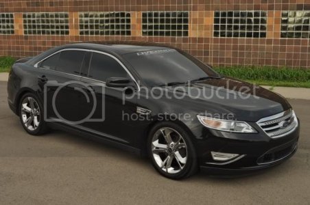

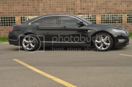

I got them and think they are great, no issues,
even rides great with the 22" wheels.
