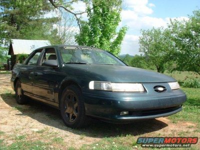

Gunmetal Slicers
I just did mine recenltly and I love them. They really accent the emerald green. I then painted my intake (runners) and valve covers with the plenums painted in silver.

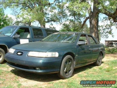

Getfilephpid119461togglefullsizefDSCF0052
Right side of the car.

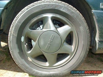

Getfilephpid119460togglefullsizefDSCF0051
Wheel up close. Just had my wheels balanced today and didn't think to take the picture of the wheel that didn't have the weight removed.
Getfilephpid119459togglefullsizefDSCF0050
Left side of car. Very dirty and in need of a good scrubbin'.

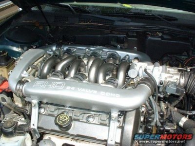

Getfilephpid119462togglefullsizefDSCF0053
Nice clean pic of the intake and valve covers.

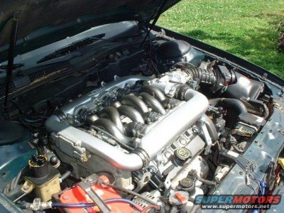

Getfilephpid119458togglefullsizefDSCF0049
Pic of the intake from the side.
Overall, I've been very happy with the gunmetal paint. It was so easy to do too. I just went to Advance Auto Parts and picked up the Duplicolor graphite wheel paint as well as the clear that goes with it. Take a scotchbrite pad and scuff up the wheels, clean with a tack cloth, spray a few coats of paint, and within an hour or two spray one or two (preferably two) coats of clear. Also, when I e-mailed duplicolor about the temps it can withstand, they said 150 degrees so I figured it would be fine on the valve covers and intake. Held up so far. Anyways, IMHO, I really like it.
