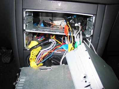

this is what im referring to, he's got the guide/holder pieces in place, and is getting ready to slide the HU into them.
Behind head unit detail
note this is non SHO but its the same basic parts that im talking about.

On my '91 there is a sliding tab that hangs down behind the deck and has a hole in it for a stud. The stud just screws in at the back of the deck and a nut holds it in place. My deck wouldn't slide in properly until I connected the old deck's stud to the back hole of my new deck and finger-tightened it. Then it slid in perfectly.
However, on my old '91+, the p/o decided to cut off the tab in question and that deck fit perfectly fine. IMO it's a matter of preference.
Finally, if you don't have a DIN sleeve (pictured above), you will need a Sony one to hold the deck in the slot.
