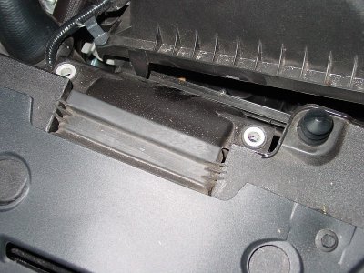

Two bolts
DSC06385 vi
Two Bolts removed

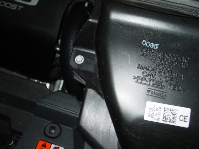

DSC06386 vi
Remove the lower airbox, now remove the third bolt.

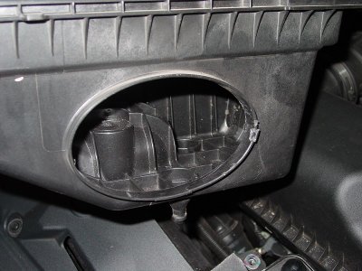

DSC06387 vi
I buggered the lip a little bit getting the snorkel out.

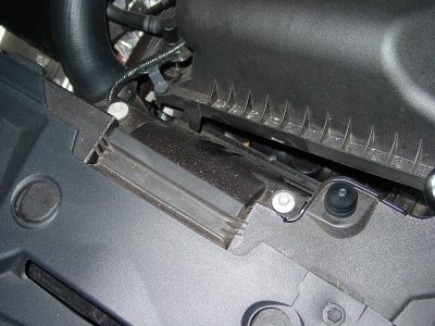

DSC06388 vi
Slap it all back together.
