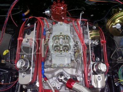

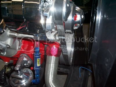

i totally agree with josh on the braided line assembly. its a real pita. and if you dont do it right it WILL leak. i just did it on a 67 camaro im building at work.
line to carb
100 0875
line from pump
100 0874
