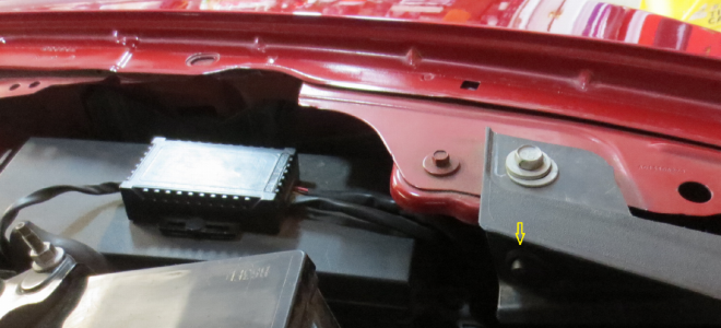

I just routed mine through the harness opening and attached the module to the top of the fuse box cover with small push pins to make it easy to remove and reinstall. The cool thing I did was installed a discrete weather resistant switch in the plastic panel (see arrow) as a circuit interrupter so with a flip of the switch I can choose between full or partial white light intensity.

6500rpm...very nice! I'd be glad to know more about the switch....not sure I'd do it...but would like to know how it works.

When you purchase the light set, the instructions give you a choice to either hook up one specific wire or leave it disconnected to determine if you want it at full brightness or reduced (I don't have the instructions with me right now so I can't give you the details). I decided to hook it up through a switch and use it as a circuit interrupter so I have a choice at any time to change it to either option with a simple press. I just picked up a small weather resistant rocker switch and mounted it in that plastic extension since it was close, out of sight but easily accessible, and out of the weather.
Bright is pretty damn bright but I don't think it's too bad for other drivers unless you're parked across from someone at a stop light. They almost work like fog lights at full intensity.
