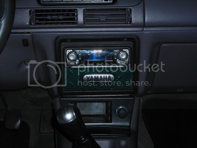

Mine

How did you drill it? What size bit did you use? Do I have to drill out the threads and re-tap it? I appreciate your help. Your original pics were what made me pick this shift ****.
I took it to a machine shop and they drilled it for free, the threads are a perfect fit but there is a lip on the shifter just below the threads that wont fit inside the ****, so you need to drill the hole bigger down *to* the threads inside the **** so that you can screw it on.
