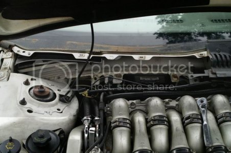

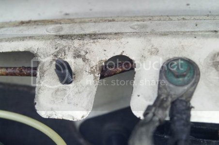

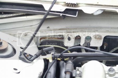

I got my 98 finished up yesterday and found a new issue with my car that I recommend most to check, mainly for those in the northern areas where salt is going to take it's toll on the steel componets.
I found this after some investigating...
ResizeofPICT2002
ResizeofPICT2003
ResizeofPICT2004
I went to seat the brake pads and couldn't figure out why the pedal was constantly going to the floor. I found the reservoir low... figured that was the problem, I filled it and continue to check for leaks and such. Walked around to the pass front wheel and found a puddle of brake fluid. I figured I had hit a line for that tire when installing the motor. Nope! Rust has eaten through the line at the holding bracket at the top of the firewall.
It really stinks too... I was so looking forward to testing out my new TC!!
You don't have to pull the plastic to check the line... just reach under the lip that the motor ground is connected to, and you should feel a smooth or rusty line... if it is the latter, pull the plastic!

I agree with you, all those in the rust belt should check their brake lines. One of the lines in the brake cluster went on me one day. Luckily it happened when I turned the car on. The thing is my lines didn't even look as bad as the one in the picture and it still went bad. Oddly enough though the one your talking about looked really good still on my car.(Gen 1) Since that, I have had all the lines replaced except one tiny one.
I seriously HATE rust.
