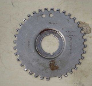

At first I thought, did I put the reluctor wheel on backwards? So, I pulled the Crank sensor out to check- Nope, its correct.

Yes, everything was in time. I found this pic and wonder if I put the wheel on incorrectly. It acts like it's 180 out.
