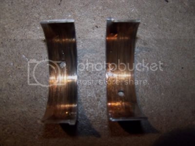

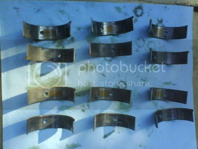

heres some pics, 125k on the car, how do the old ones look?

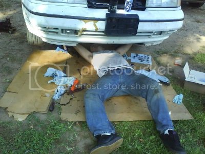

and NO thats not a torque wrench in my pants, i just love getting dirrty with my car

those are nice as **** rod bearings.......... not a lot of wear at all...
atleast you know they are good now, way better to be safer then sorry

yeah, i had noticed the oil pan looked like it had been off before, but idk for what,
i know the people that had the car before me were car enthusiasts(father and son) i believe that they did do good maintenance on the car.... probably equally beating the shit outta it too though, lol
so i guess im wondering if that looks like 125,000 mi. of wear, or if they look like they were done before,

those are actually pretty nice lookin ones ya got there
take a look at mine after 119,000
now these are bad, especially # 1 and # 6

In the absence of knowing how well the vehicle and engine were maintained by the prior owner/owners, there's really no way of judging/rating bearing wear versus mileage on the engine bearings. There have been posted images of 200,000 mile V6 SHOs with bearing-wear similar to Adumb's, and engines with less than 100,000 miles worse than yzstud's.

Nice job on changing the rod bearings. They didn't look all that bad. You asked if people thought they were the original and I would have to guess they were. See you around.

um, i had my roommate there to **** up the bearings, hand stuff to me, and turn the engine when i needed, otherwise i woulda been crawling in and out from under the car,
for me that = frustration,
but probably like 5 hours or so, i was taking my time,
if your working off the sho phoenix walkthrough, a good idea once you get the cap off is to put a small piece of fuel tubing on the bolts, it helps keep them from hitting the crank

Looking good. You can never be too careful. Now you can get an idea of where to start to keep up with maintenance.
