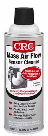

serious q, MAF cleaner? different then any other electronic cleaner i have?

ty91sho
EVRYDAYHUSTLIN'
Oct 23, 2006
938
44
st.cloud MN
i was told it was different then just elec. cleaner. but idonno i would give it a shot if it was my car. and with the fuel filter it isnt bad at all. just loosen the hose clamp holding it up in there and then take the two plastic snap clips off on both ends. these usually break but you should get new ones with the new fuel filter. and or just be carfull if your just checkin to see if clogged. and there will be about half a quart of fuel that will run down your arm haha, then when puttin back in prime the fuel pump twice before startin up and you should be good to go.

How about the fuel pressure regulator? You said you smell gas under the hood, its a possibility. My brother had the ****** of one rust out on him and it was leaking gas all over, but it took him a while to realize it.

i need to get that just for the added wheel HP

Yes, MAF cleaner is diff. I wouldn't try anything else unless you know for sure it's safe for the sensor, as it may ruin the sensor!
