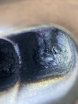

i sprayed it through my vacuum line, didn’t clean anything though. granted my valves were pretty bad
