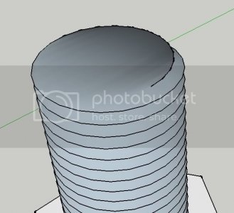

What you need is another crank bolt. See if it'll go in. If it does, great.
see how the end thread is tapered down? you can grind that with just about any hand file or even a knife sharpening stone.
Threadentrance

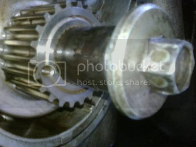

SHOforum, you guys just plain ROCK! That's all I have to say. Thank you so much for your help everyone, especially Tom and Tom, lol. A $5 M14x15 tap from Napa, a helluva lot of WD-40, and a 3/8 socket and that sucker went right in and repaired the threads. Crank bolt will now screw all the way in (I hope ALL the way; if not I have a bottoming tap coming to finish the tip if need be). But all in all, it should be FIXED!!!! I do suck at working on cars, but I CAN do it! Took all of 2 minutes to fix what I thought was a ruined motor. I haven't fully got the car assembled, but I'm hoping the bolt will go in as far as it needs to go and that I don't have any issues once I re-assemble everything.
Pic to prove it's fixed!
Crankboltfits

Booyah! We knew you could do it; only you had doubts.
If you find that the crank's threads do in fact need re-tapping all the way in the back, AND your new tap has a smaller shank than its cutting teeth (some do, some don't) you can grind off the tapered part of your tap and make a bottoming tap out of it. A dremel or just a bench grinder will do it for you.
Congrats on winning.
