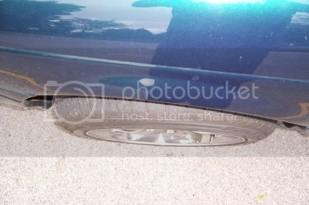

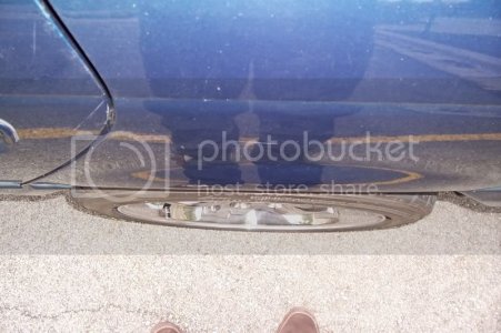

Have reinstalled rear ground effect endcap, material removed to accomodate bigass tire... 245/45-17 on 17x9 CobraR's (made in China!). Rolled rear fender as well as 5mm spacer in the back. Also depends somewhat on which tire you use... some are square some more round... round ones fit better.
Mostly you'll need to space the wheel out so as to not rub on the strut tower, and roll the fender cause you spaced the wheel out.
FWIW they look like this (@NHMS Convention 18?): http://s22.photobucket.com/albums/b331/Platoribs/Green at the Track/
and this V
Greenieon17s003
and this V
Greenieon17s004
and this V
Greenieon17s001
You'll also probably want to upgrade the rear brake to the 92 big mouth caliper w/11.6 rotor reloc bracket, otherwise your rear brakes will look tiny...
