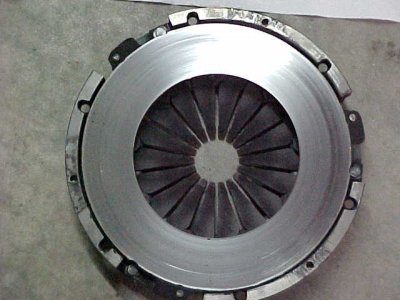

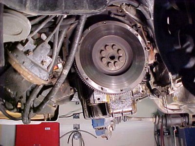

It is indeed the new one that Josh is selling. He's offering it at a phenominal price as well. I highly suggest this clutch kit for those of you who like a stock feeling pedal and mucho grab.
Pics of the 9 puck disk can be seen here. These pics are of my car when I was at his place earlier this year for tranny work. The only difference in my kit and Josh's is that mine has a stock PP instead of a reinforced one. That puts extra value in Josh's kit since he's priced his based on what I paid for mine but he gives you a reinforced PP instead of stock. thumb
Yet again, Josh has outdone himself. wink
Pucked disc
Pucked disc flywheel
Pucked disc PP
