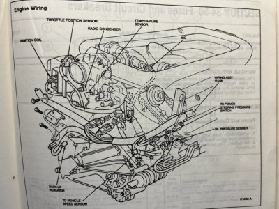

I gave it another try today. Got the engine hot and disconnected the temp sensor wire. I waited till the needle was almost in the red. The only thing that happened is the temp gauge went to cold. No difference with the fan. Still didnt come on. That makes sense that there are 2 sensors. But I cant find the other one if its there. Here is a photo of the engine wiring from a shop manual showing only one sensor. I believe manual trans cars have one fan and automatics have two. Wiring and sensors could be all different.

The ECT sensor on my '95 MTX is further toward the firewall and a bit lower than the sender for the gauge. The single post gauge sender is the one labeled in the diagram. If memory serves, the connector is gray, and it has 2 wires. In the diagram you attached I think it is the wires to the sensor that is not labeled down and to the right on the diagram. It is somewhere in that area anyway.
The CELO (Cold Engine Lock Out) switch is also in that area, but closer to the firewall in the hose/pipe to the heater core if you have EATC. That also has 2 wires I think, So maybe if you are on good terms with your local NAPA, O'Riellys, etc ask them to order the ECT for you so you know when you are looking at the correct sensor.

Rich, So if I call the ECT in this picture is at 4 o'clock, then the single post sender for the gauge is at 7 o/clock. This should help you find it.
HA! I think I can find it now. Thanks for that diagram. That is a huge help. I cant believe the shop book didn't mark it.
