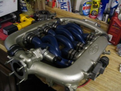

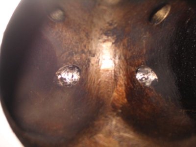

EGR Nostrils photos
Here is a shot of the EGR nostrils location. They are the lower set of holes behind the throttle body. Mine were covered w/ soot giving me a few EGR related codes.
www.emprepcourse.com/misc/intake_95ATX.jpg
Intake 95ATX
www.emprepcourse.com/misc/EGR_nostrils.jpg
EGR nostrils
Cleaned them w/ carb cleaner and #18G wire, being careful to keep the fluid out of the other holes (lead to the IABP valve).
