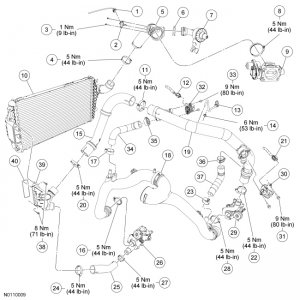

Ok guys, 2010 non pp, I've gained a boost leak that I can audibly hear from the drivers seat, sounds like it's right behind the passenger firewall. I've searched this thing all over and I can't find it. So 2010 guys, where would it leak if it was gonna? I don't feel a power loss anywhere except first acceleration. It's as quick as it's always been. I'm lost. It is my first sho and I've only had it like 8 months

Check the blow off valves for a torn diaphragm. #30 and #32. Remove screws #31 and #33 to remove valve and inspect diaphragm.

Ok I pulled both valves out and the orange\red rubber and the blue looks good. It springs back and forth good. I'm at a loss

Check the parts shown in the diagram above that’s everything boost related before the throttle body. Grab some soapy water, turn the engine on and start spraying connections and look for bubbles
