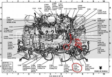

I know im an idiot... but I don't know where my canister is on my 94ATX. I have my manual somewhere (Just moved everything still boxed up) but cannot locate it. Thanks for the help. I need to replace all my Evap/EGR components asap so I can pass smog. (bout $200 for EVERYTHING)
THanks fellas.

Well, the canp is easy to find. See that vacuum line running from near the throttle body? It goes straight toward the ground, it's a smallish one. It goes to a little brass can thingy that has two vac lines and an electrical connector that goes to it. That's the CANP solenoid.
Here's pics to help.
CANP
Oh, and you can get the part for cheap here:
Here

Yep thats the part I have... Just couldn't locate it off the top of my head. Im a V8 finatic... so I know where to find them on any RWD V8 Mustang (my fam has about 8 of em not including mine) Thanks big time
