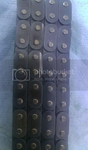

I had a set of high mileage chains, and when I compared them with a new set I bought, there was very minimal stretching. The only stretching that did occur, was in the sides of the chains, giving them lateral movement. That was the source of my valvetrain noise!
The pins that hold the links together stretch, which give the chain more lateral movement. You can tell, because some of the links (like pictured below beside the new chain) have rub marks on them.
