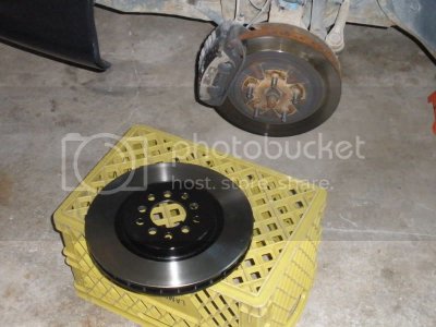

Pic of the new 13" next top 12". 12" to go on the Super Coupe.
P7100069

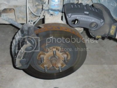

Pic of the Cobra PBRs as received from Gene. He got the SHO calipers.
P7100071

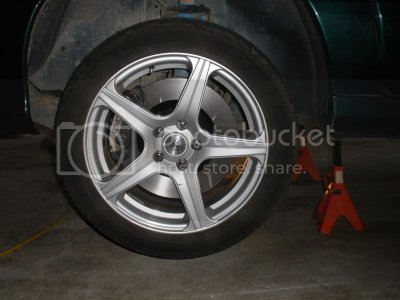

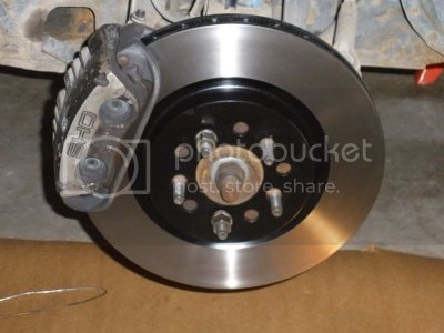

13" rotors on Bull.
P7100072
With wheel on.
P7100073

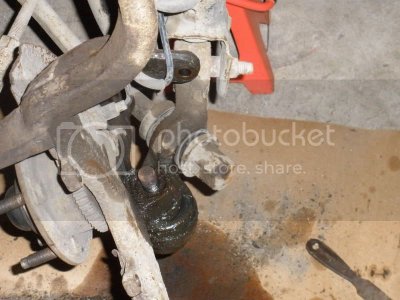

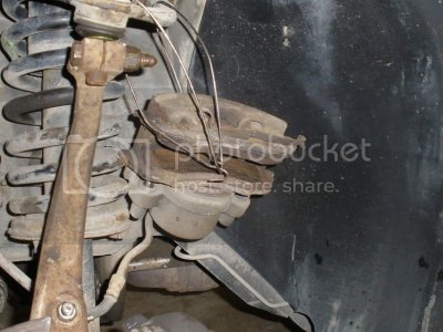

Forgot to take shots of Super Coupe prior to start but this shows the bad condition of bushings on the Tension Strut rod. Had to replace spindles from 1991 to 1993 to accommodate the brake package.
P7200084
P7200085

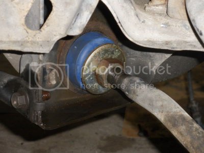

Pictures of new front TSR bushings.
P7230090

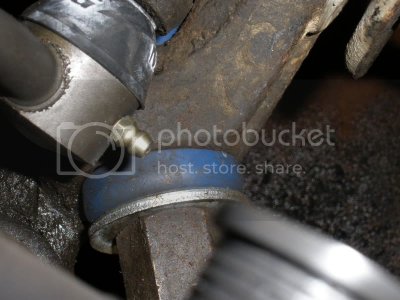

Pics of new rear TSR bushings. And new end link.
P7230094

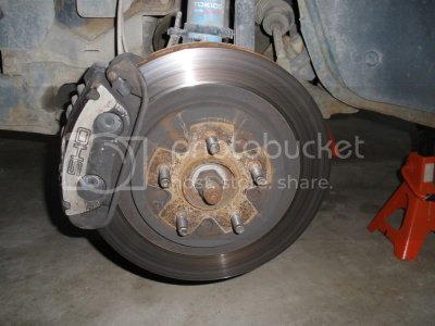

Old caliper.
P7230091
New Cobra caliper mounted. Off to the tire shop for an alignment where the right front upper control arm ball joint and lower tie rod were determined to be failing so had those replaced prior to alignment.
P7230092

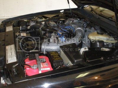

2 pics of the Super Coupe's "lump".
P7200086
P7230093
